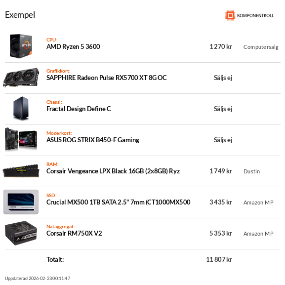

AMD Ryzen 7 3700X | EVGA GeForce RTX 3080 10GB FTW3 ULTRA | ASUS ROG Strix B450-F Gaming | Corsair RM750X V2 | Crucial Ballistix Sport LT 3200MHz 16GB | Samsung 980 Pro 1TB | Crucial MX500 2TB | NZXT H500
