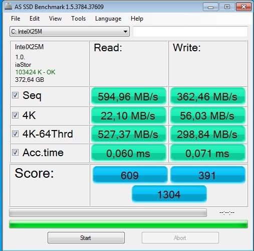

Mina 2 Intel X-25 M 80 GB G2 i raid 0:
Asus Prime X470-pro | AMD Ryzen 7 2700X | Corsair H115i | MSI GTX 1070 Gaming X | G.Skill Ripjaws 32 GB 3200 MHz | Samsung 970 EVO 1TB | Corsair RM750x v2 | Fractal Design Define S
Kör intel ssd i raid 0
