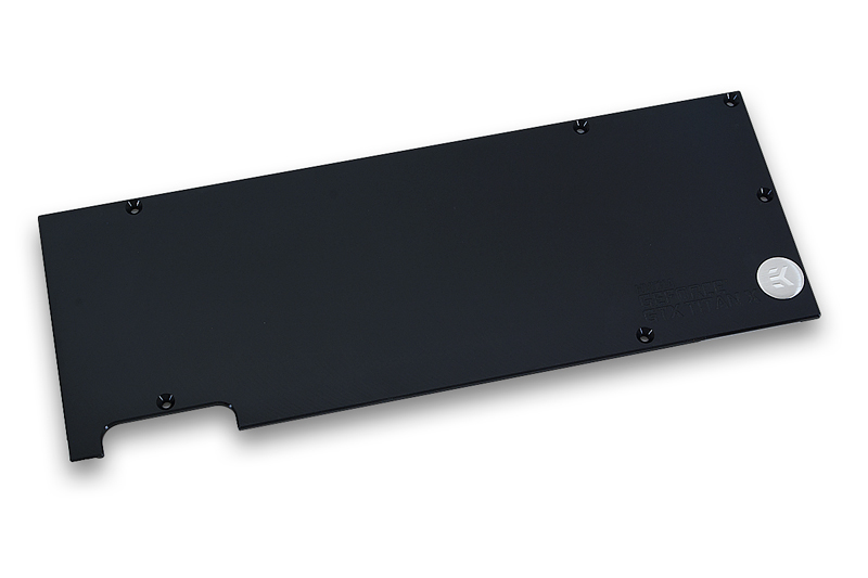

. EK-FC Titan X https://www.ekwb.com/configurator/upload/pictures/FC-Titan-X_...
. EK-FC Titan X backplate https://www.ekwb.com/configurator/upload/pictures/EK-FC-Titan...
